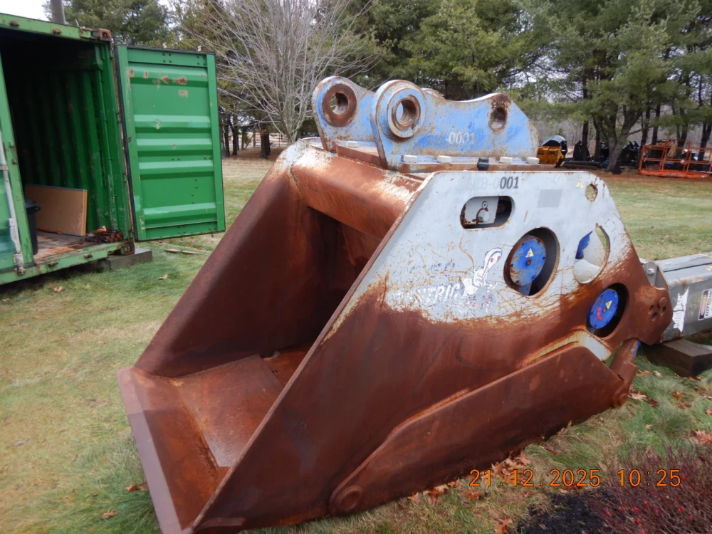

XCENTRIC XC50 130+YARD PER HR JAW CRUSHER 400 - 650 CLASS EXCAVATOR 2 YARD BUCKET REPLACES A MOBILE CRUSHER FOR ONSITE CRUSHING

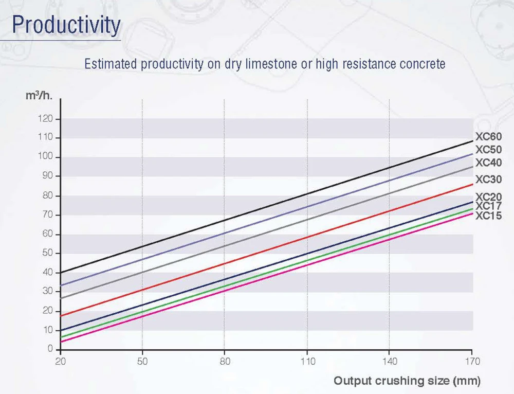

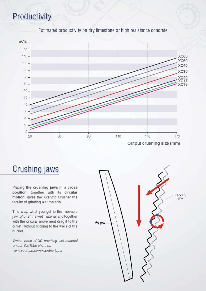

- Crushing output: 130+ cubic yards per hour
- Crushes reinforced concrete (rebar included)
- Handles hard granite and basalt
- Processes wet or dry demolition debris
Replaces On-Site Jaw Crushers
- Loads directly into trucks or stockpiles
- Up to 10 tandem 13-cubic-yard dump trucks per hour

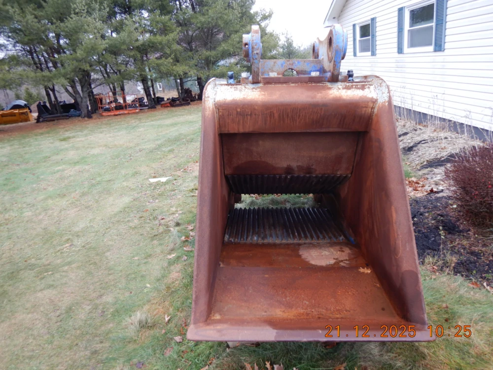

Adjustable Output Size
- From 1/2"–1½" minus up to 5" product
- Granulometry adjusted in under 5 minutes
- Only two pins required to change jaw setting

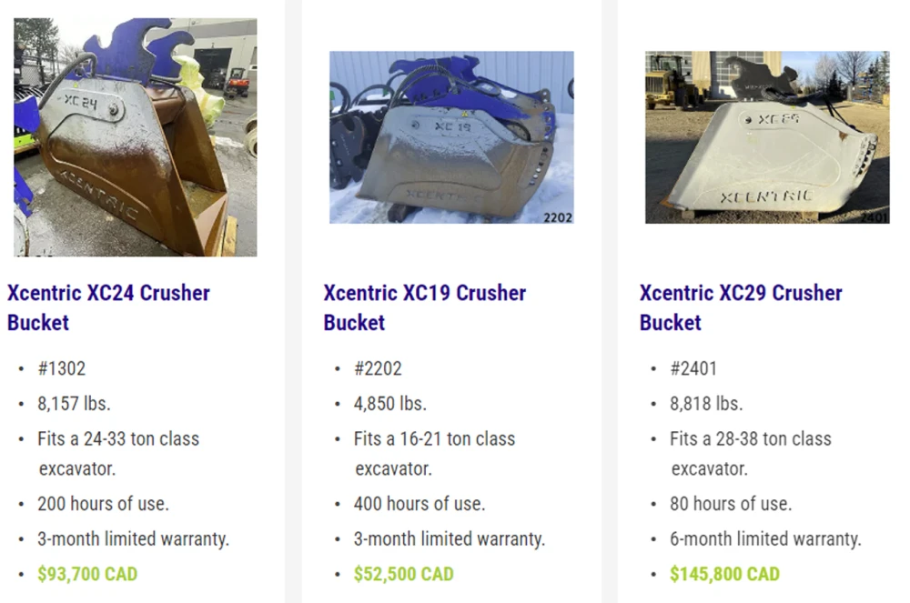

- Compare: Used XC29 (half the size) retailing at $145,000 CAD
- Only used XC50 available worldwide

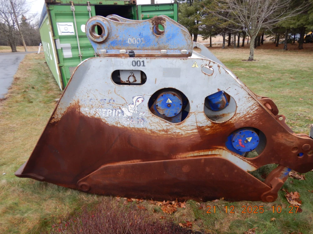

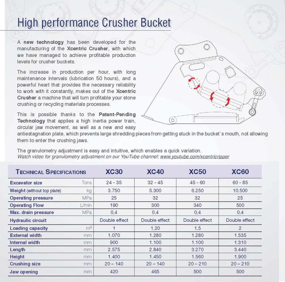

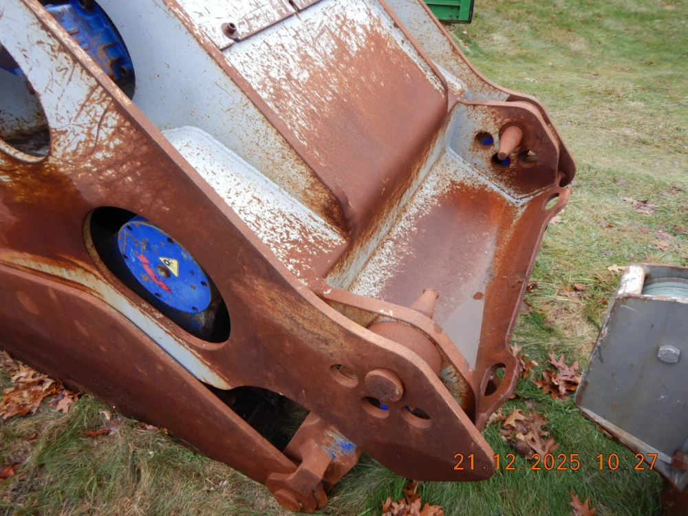

- Model: Xcentric XC50
- Year: 2020 – low-hour unit due to COVID shutdown

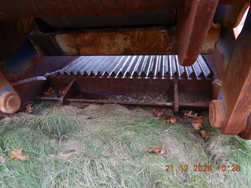

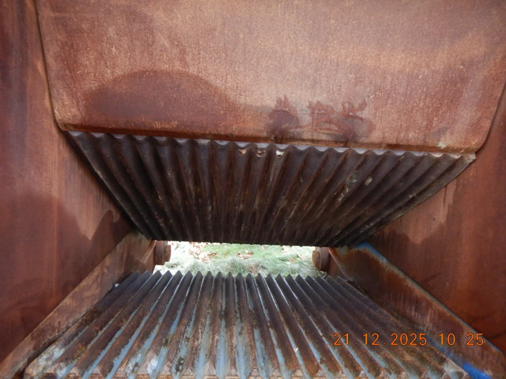

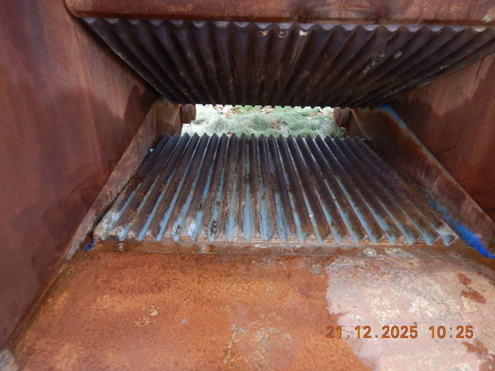

- Original jaws over 80% | Original paint & decals
- Carrier class: 38–65 ton excavators (ideal 45t+)
- Weight: 6,250 kg
- Jaw opening: 1100 mm x 500 mm
- Crushing volume: 1.5 m³ (approx. 2 cubic yards per bucket)
- Materials: HARDOX® 400, SSAB & STRENX
- Stock #: XC50-0001

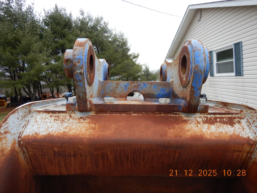

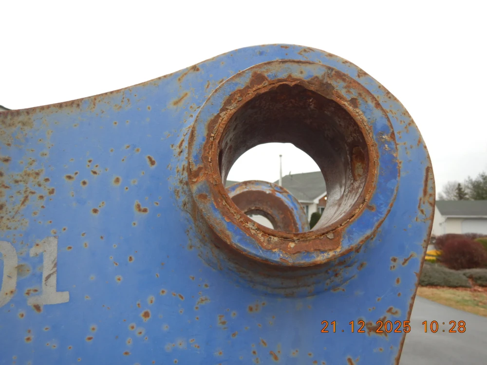

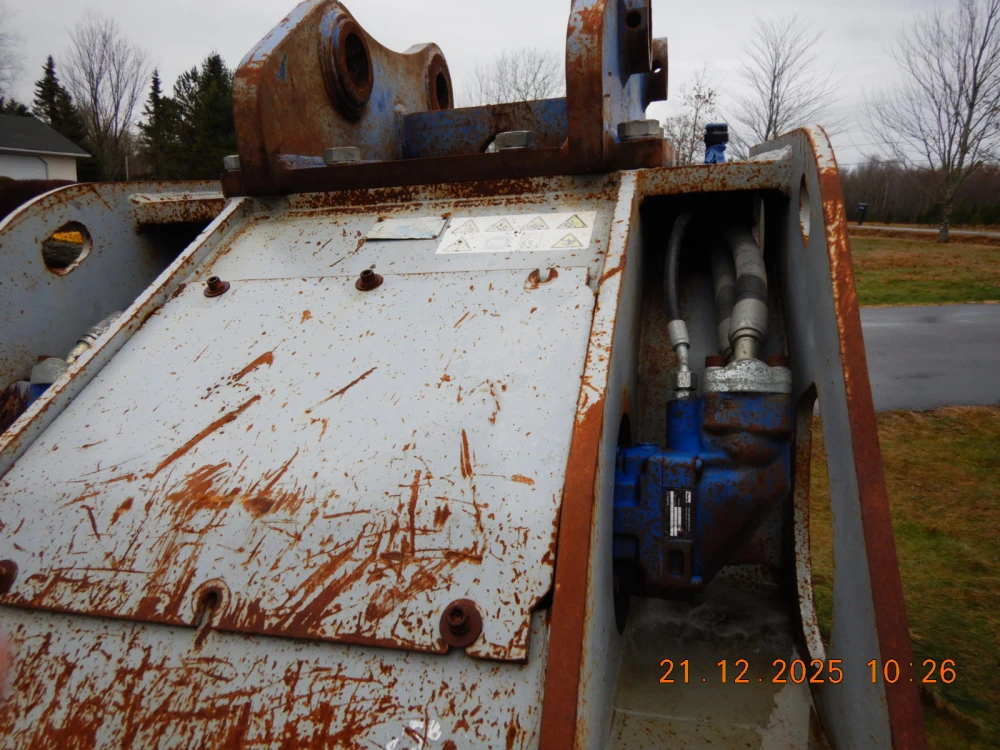

Current Pin Setup
- Front pin: 100 mm but remove bushing for 110 mm – 18.5" between ears
- Rear pin: 100 mm – 16.5" between ears
- 22.5" center-to-center pin spacing
- Currently set up for KOMATSU PC 450LC BUT also works on Volvo EC480LC and EC380LC

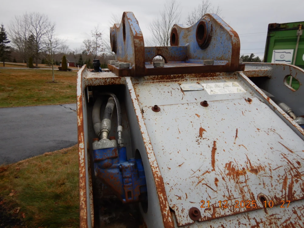

Engineering Advantages

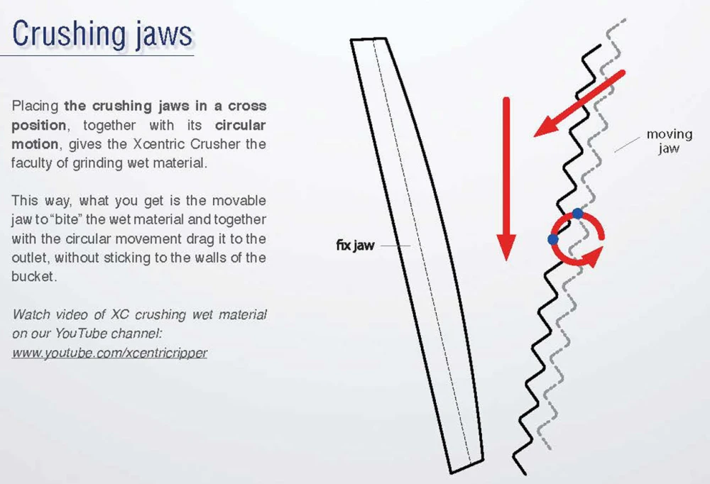

- Patent-pending circular jaw motion for higher output
- Crossed jaws crush wet or sticky material
- Double-effect system reverses instantly if jammed
- Anti-stagnation plate prevents blockages
Low Maintenance Design
- Greasing interval every 200 hours
- 80% fewer wear parts than conventional crusher buckets
- No springs, spacers, toggles, or silent blocks
- 40% less hydraulic oil required
- Standard hydraulic components available worldwide

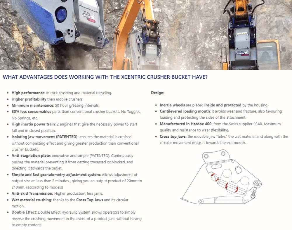

Key Features & Benefits:
- High Production: Achieves over 130 cubic yards per hour by utilizing a high-inertia power train and circular jaw movement.
- Handles Wet Materials: The circular motion and cross-top jaws bite and drag wet material through the crusher, preventing clogging.
- Minimal Maintenance: Long intervals (e.g., 200 hours) between greasing reduce downtime.
- Anti-Stagnation Plate: Patented design stops large pieces from getting stuck, ensuring continuous flow.
- Durable Construction: Built with Hardox 400 steel for longevity.
- Granulometry Adjustment: Quick and simple system for changing output size (e.g., 20mm to 210mm).
- Double Effect Hydraulics: Allows for reversing the jaw movement to clear jams without emptying the bucket.
