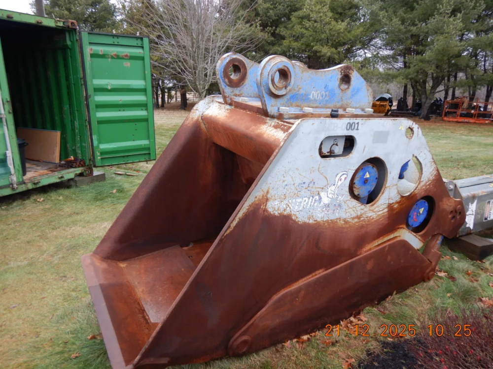

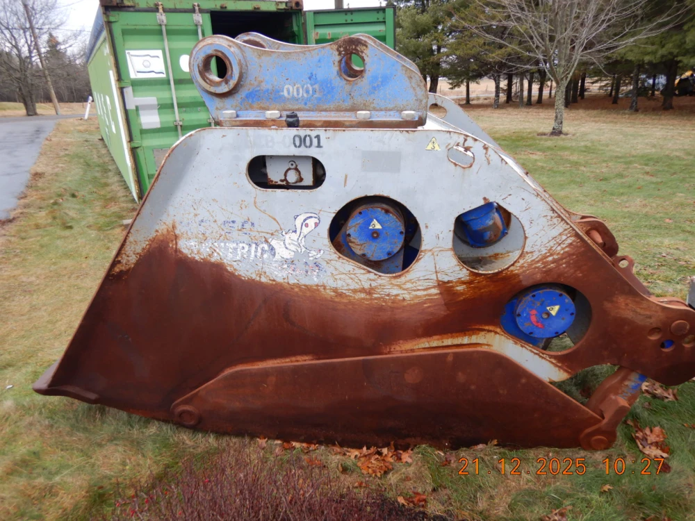

XCENTRIC XC50 400-650 EXCAVATOR JAW CRUSHER BUCKET 130 YARD P/HR

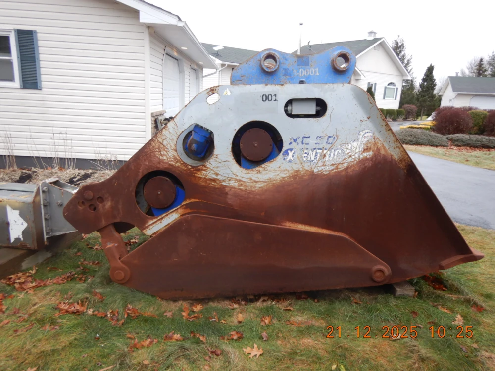

SHEARFORCE HAS 1/2 THE BUCKET FOR TWICE THE PRICE - SEE IMAGE 3

⚠️ Compare: Smaller used XC29 (½ the size) from Shearforce retails for $145,000 CAD - see image #3

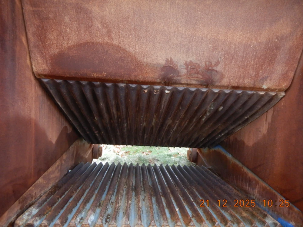

Year: 2020 - LOW HOUR UNIT DUE TO COVID NOT BEING USED - ORIGINAL JAWS OVER 80% - ORIGINAL PAINT AND DECALS

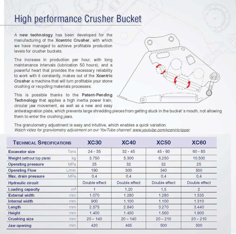

Carrier Class: 38–65 Ton Excavators (Ideal: 45t+)
Note: We have a New Dealer Take Volvo EC380 off 8 foot stick we were going to mount on a EC380LC Volvo for quicker - easier - cheaper moves available for both this unit and the Rocktec Terminator 75000 ft lb drop hammer
Machine requires only a 2 way Hydraulic thumb circuit and case drain line - move the jaw bucket between mutltiple machines on multiple sites as required.
Weight: 6,250 kg

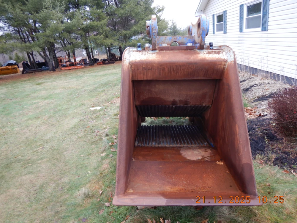

Jaw Opening: 1100 mm x 500 mm
Crushing Volume: 1.5 m³ per bucket = 2 Cubic Yards per bucket
Materials: HARDOX® 400, SSAB & STRENX

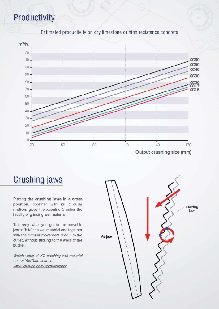

⚙️ Patent-Pending Circular Jaw Motion = Higher Output with Less Compaction
Crossed Jaws enable crushing of wet or sticky materials
Double-Effect System: Instantly reverse jaw if jammed—no need to empty
Anti-Stagnation Plate: Prevents large blocks from clogging the inlet

Crusher buckets are jaw-type crushing attachments mounted on excavators. A rotating hydraulic motor powers the movement of the jaw, which crushes materials against a fixed surface. These attachments process material on-site to reduce size (typically from ¾ inch up to 6 inches), making it easier to reuse or haul away.
